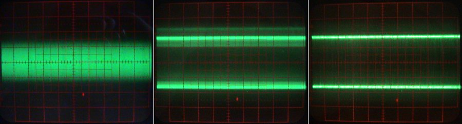

The TBA120S has enough gain to give a significant output from its own noise, but usually not enough to go into hard limiting on it alone.
If you have an oscilloscope, you can check for cca 200mVpp of noise at pins 6 and 10 of the TBA120s, and the same signal on pins 4,5,9 and 10 of the LM319s.
The signal should look like this: (NOTE: these are pics from an analog 'scope, I am not sure what a DSO would spit out...)
If nothing is connected to the TBA120 inputs, you should get
approximately the left picture. Scale is 100us/div horizontal (not very important) and 100mV/div vertical.
Connecting the tuner (or another IF noise source), without the lowpass filter (make a bypass
like this:)
you should get the center picture - the TBA120 is now in hard limiting regime. The bright band around the top limit is caused
by ringing (bad probe ground), and should ideally not be there.
Inserting the 200kHz LP filter, you should get the right picture above. TBA120 is still in the hard limiting regime, but there are less transitions,
so there is less "fog" between the limit levels.

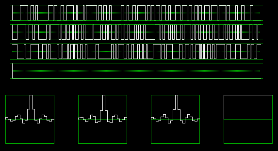

There should be a random TTL signal on pins 7 and 12 of the LM319s.
For the same three cases as above, you should get approximately this on pins 7 and 12 of the LM319s:

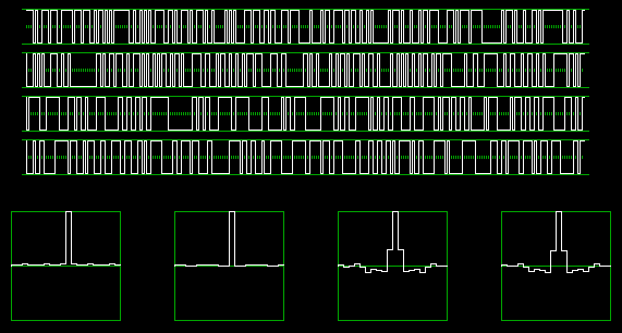

If everything is working well, the display of the tuner noise coming through the LP filters should look like this:
The time traces on top should display random square waves, with about the same average density of transitions in all channels.
The autocorrelation displays should show nice peaks at zero offset (center). The narrower the LP filter, the wider will be the autocorrelation peak, so this can be used to see if the LP bandwidth is well matched to the sampling rate. The picture above is for a 0.7 Nyquist LP (200kHz LP with cca 600kHz sampling), a good value.
It is OK if your autocorrelation plots look a little different from the picture above, the impotrant thing is that they should be as similar among themselves as possible.
If any of the channels looks significantly different than the others, you have a problem and must sort it out. It could be a bad solder joint, interference intrusion, self oscillation etc. BTW, first check that there is really nothing connected to the inputs! These are very sensitive, and a piece of dangling wire can act like an antenna, bringing HF mayhem to your IF!
The FFT program described below can be of some help when checking for interference.
If there is no QRM or oscillation, check the LP filter for that channel, probably one of the component's values deviates.
A totally dead channel will show up as a "flatliner", like the fourth channel below:
In this case, use an oscilloscope to check the TBA120 and LM319 outputs, or of you don't have one, switch the outputs to locate the problem to either IF strip or LPT port/cable.

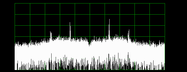

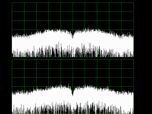

This is a complex FFT analyzer, showing the spectrum from minus Nyquist (half of the sample rate) to plus Nyquist, with DC (frequency zero) in the center. Later, when used with the tuner, the zero frequency represents the frequency to which the tuner is tuned (it's LO, because it usess direct conversion). The negative frequencies then represent frequencies below the LO frequency and the positive frequencies the ones above the LO.
With nothing but tuner noise through the LP filters on the inputs, it should look similar to this:
This program is a very bad (tiny dynamic range) spectrum analyzer, because the input samples are one bit only, but it will show any narrowband interference.
If you have some DC offset, there will be a spike at the center, which does not represent interference.
Because the amplitude information is lost in one bit sampling, the characteristics of the LP filter can not be seen, all that remains of it is the slight bump in the noise level.
The sampling routine in this program runs somewhat faster (on some machines) than the one in the original sidi program, so the LP band edge is closer to 0.5 Nyquist than 0.7 in this image.
The dip at the center (zero IF) frequency is caused by the capacitive coupling of the baseband I and Q signals in the tuner.

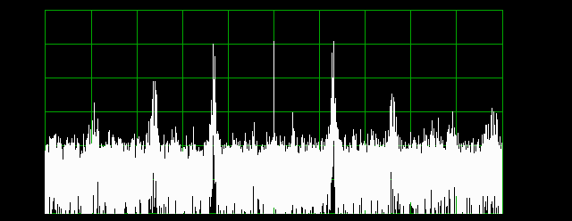

If you see any interference spikes, like this:
check first for any switchmode supplies around (PC, monitor, other PSUs...) and try moving the devices that contain them,
to see if anything changes. The horizontal deflection of CRT monitors is also a big source of interference, and even LCD monitors have some "hair", because they contain converters for backlighting etc.
Because a QRM signal intruding in the IF is extremely unlikely to impinge into I and Q with perfect phase quadrature, in most such cases the image rejection will be very low, and the IF offender will show as two almost symmetrical (around center) spectral lines.
If you have an strong QRM signal that by itself drives the TBA120 into limiting, you will see this:
Note the fact, that the saturation has caused a reduction and equalization of the noise level, and produced a DC spike. On the time domain display, it will look similar to this: (your frequency will probably be different)
and if the frequency is high enough, you will also see that the autocorrelation fuction has become periodic:
If you can not find a source of external QRM, and especially if it is very strong, self oscillation of the IF strip is a possible explanation.
This can have many causes, but bad grounding is the most probable. This is a high gain circuit, and you must observe good RF building practices when constructing it, like a lot of well connected ground (and shielding), no long dangling wires, well filtered supply, etc...

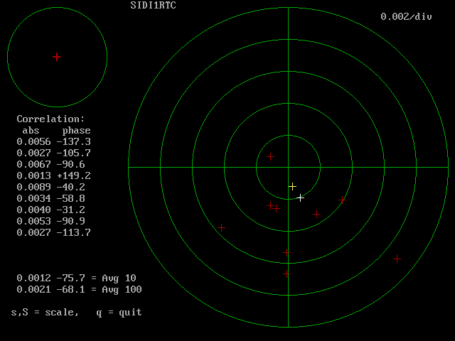

To do this, run the "real time correlation display" program
sidi1rtc.c
if working with LPT/DOS, or else
xxxx.c
when working with USB/Linux.
This program displays the complex correlation between the two channels:
The small circle upper left diplays the whole circle of radius 1 in the complex plane, and the tiny circle within it indicates the area which is displayed enlarged in the big circle in the center of the display.
The red crosses are the correlation value calculated from one "chunk" of samples each, (128K, or 2^17 samples by default), the yellow cross the average of ten successive chunks, and the white one the average of 100 chunks. These last two only show up after a sufficient number of samples has accumulated. Press s or S to zoom in and out, and q or Q to quit the program.
First we check the zero point, when the inputs are fed with totally uncorrelated signals. For this you need at last two IF noise sources, each feeding one of the channels (I and Q fed from the same source). Even better would be four separate IF noise sources.
Tuners can be used too, of course, but to be sure that their outputs are uncorrelated, tune each one to a different frequency. (Use the programs described below in the tuners section.)
Because this is noise statistics, the crosses will of course not sit still at zero correlation, but will jump around somewhat. The RMS amount of jumping will be approximately inversely proportional to the square root of the number of samples averaged.
Considering that we average 130K, 1.3M and 13M samples for the red, yellow and white crosses respectively, they should stay within circles of cca 0.003, 0.001 and 0.0003 radius, centered on the current value of correlation, 65% of the time.
With uncorrelated noise at the inputs, they should be distributed symmetrically around zero (display center), meaning zero average correlation. If they are shifted in any direction, there is some common signal intruding. Here we are much more sensitive than the FFT display above, because much more samples get averaged, compared to the 16K FFT size used in sidi1fft. So, even if there was nothing to be seen in the FFT display, there could still be some QRM coming in. Try some more of the QRM locating and removing procedures described above. Insufficient supply filtering can bring correlated signals into the two channels - try supplying the IF strips from a (small) 12V battery, maybe even two separate batteries.
Sometimes, it will be impossible to totally remove any residual correlation. If it is constant, and not too big, such a residual can be often tolerated, since it will only produce a DC pedestal on the otherwise AC fringes. Typically you will see something like the screenshot above, this amount of fixed correlation can be tolerated in most cases.
Next, check the "full correlation" point. Connect the same nosie source to all four inputs. The reading should jump close to 1. With a well matched set of 200kHz LP filters, it will be close to 0.99.
Because there is still some independent noise generated in the channels themselves, it is not possible to get a value of exactly one.
However, if you get less than 0.9, try to find out why. Check the time traces with "sidi1tdd", they should be almost identical. The most probable cuse of reduced correlation is bad filter matching, this can also be seen as unequal autocorrelation curves on the "sidi1tdd" display.
