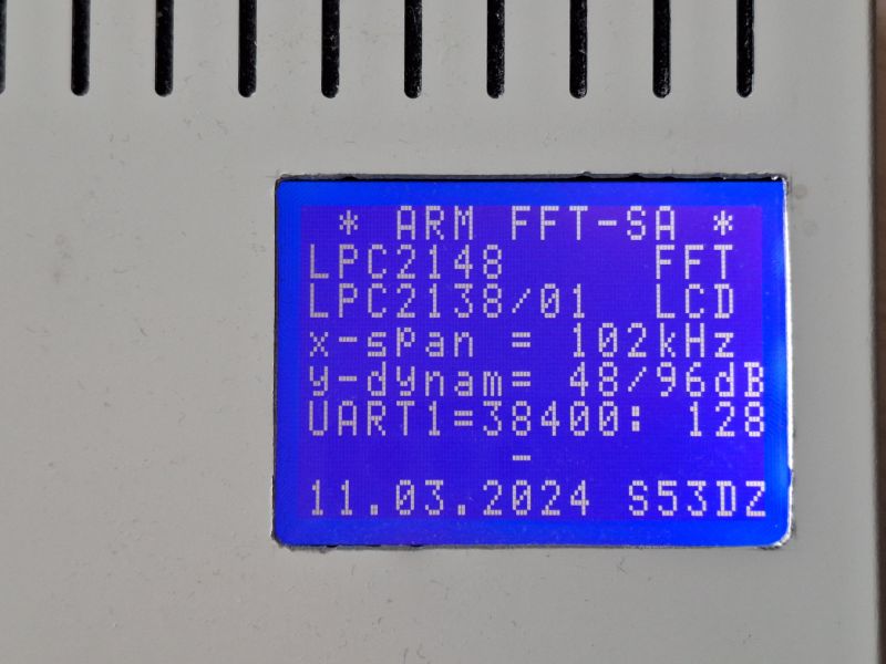

ARM FFT-SA with DEM Display
Test: Dynamic range = 96dB and
Frequency span = 51kHz
ARM FFT-SA End results:
the two ARMs running at 72MHz
Y = 48/96dB, X Span = 102kHz

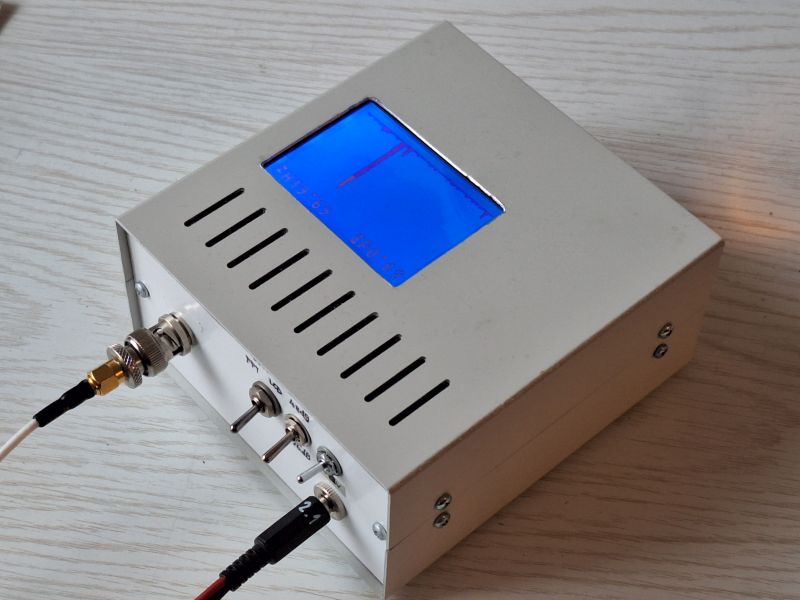

ARM FFT-SA in Alu enclosure

The final version of ARM FFT-SA is built of three units:
- FFT with
Ursus(LPC2148),
- display with
S-ARM(LPC2138/01)
and
- graphic LCD
DEM128064H
At the ARM A/D FFT input there is a DC bias circuit, a voltage limiter and a LPF filter.
A good
105kHz LP filter
is needed to minimize the aliasing effect.
