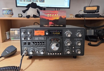

Yaesu FT-101Z(D) "aftermarket" frequency counter - Some time ago, a well-preserved Yaesu FT-101Z transceiver appeared at a local flea market. In the early 80s of the last century, when I started my amateur radio activities, the then popular FT-101Z(D) transceiver looked like a "spaceship" and far out of reach for a newbie like me. Therefore, even after all these years, I could not resist buying it when I found one ;). Following the design of the frequency counter for the TS-820(S) built two years ago, I decided to design and build a digital frequency counter for the recently acquired FT-101Z as well. |
