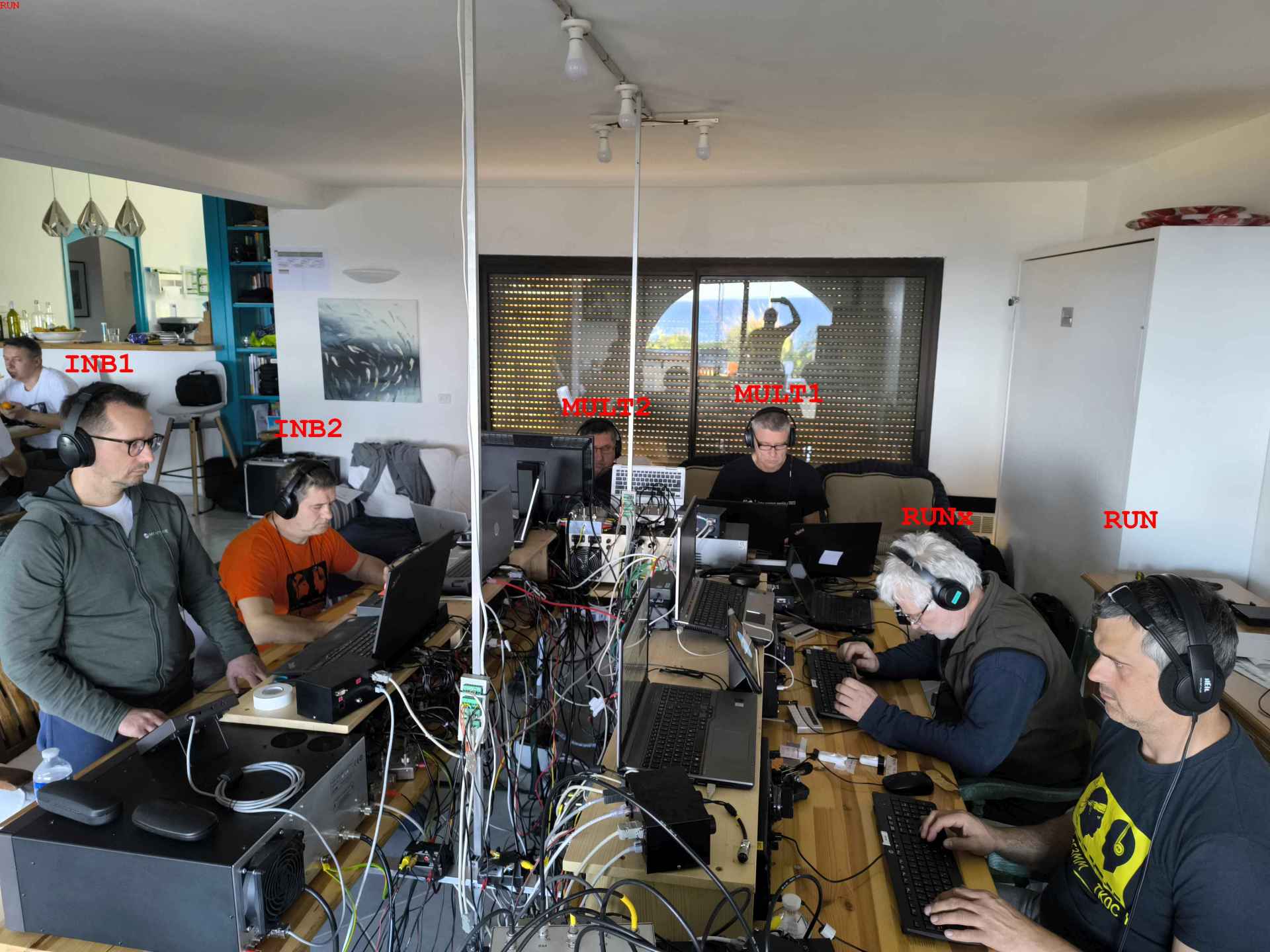

- two RUN operators (RUN and RUNx), each listening to different RX antenna/direction (RUN on 2Vw and RUNx on 2Ve)
- two INB operators, each listening to different RX antenna
- audio recording is from RUNx position (i.e. all the signals are from 2Ve RX antenna)

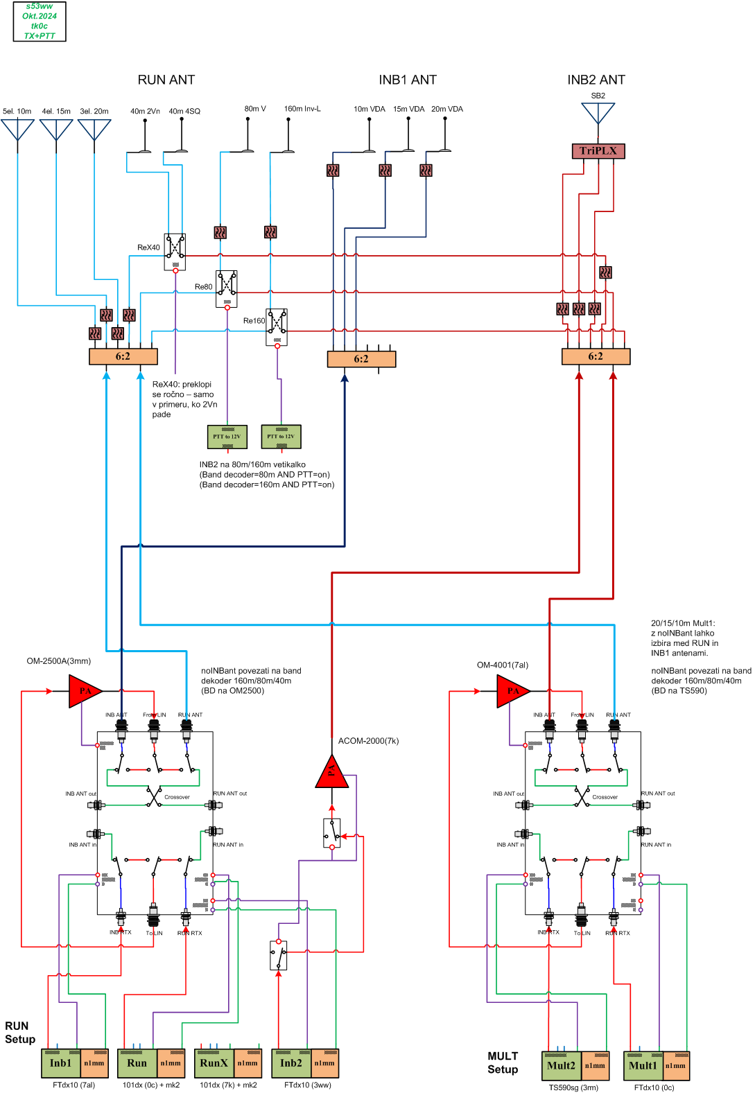

- all OPS TX on the same, TX-only, antenna (2 phased verticals oriented to North, some 10m from the see front)
- RX antennas are also 2 phased verticals (identical to TX
antenna), one oriented toward 310 degrees (2Vw) and the other to
45 degrees (2Ve)
- the directivity of RX antennas is very high between the two main directions, so you can only hear very strong US signals on 2Ve
- you will see RUNx working mainly stations from east and RUN from west
- the isolation between TX and the two RX antennas is not the same
- isolation between TX and 2Vw is almost 80dB which is very good
and you can only hear the other station TXing when the separation is
less than about 3kHz
- isolation between TX and 2Ve is about 15dB worse and you will
notice interference when INB1 or INB2 is TXing (if listening to 2Vw it
would be zero interference)

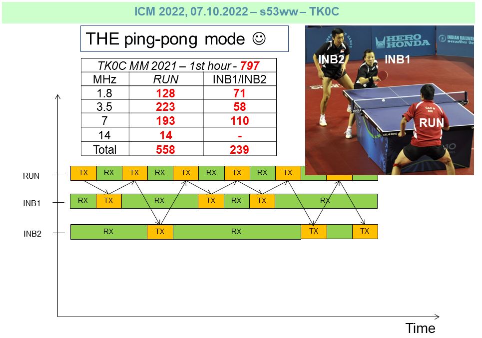

- INB is very similar to 2BSIQ with the main difference that
2BSIQ OP is the one that dictates the sequence/rythm on both bands,
while here the RUN OP dictates, or at least tries to, its own rythm whild
INB OPs need to adjust to the sequence of the station they are calling
- these are inveitable gaps beyond the swithcing times and human reaction delays.
