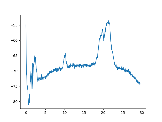

The same precipitation can be observed in real time on the beat spectrum of the described FMCW radar:
S09

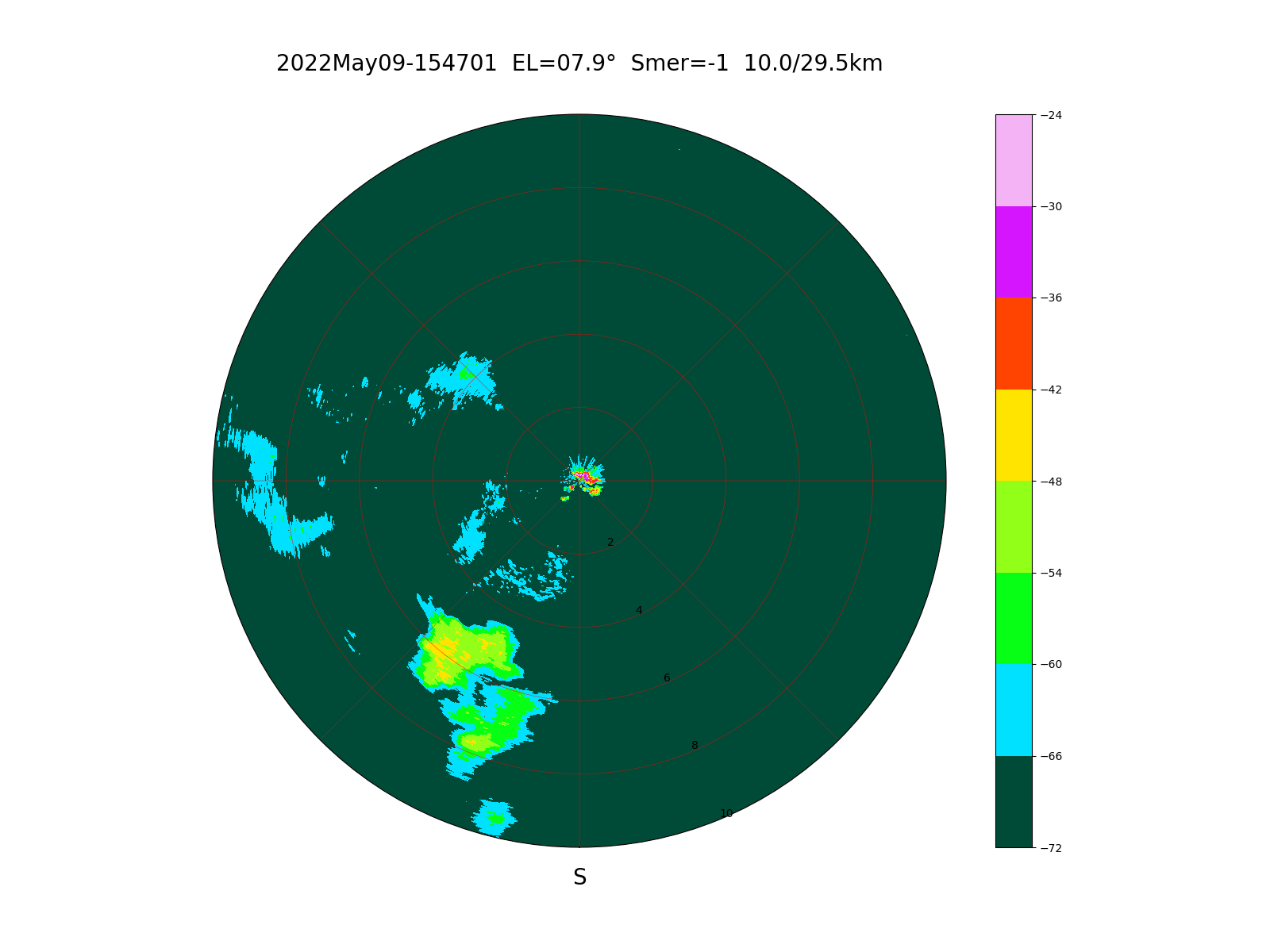

The corresponding PPI image was taken a few minutes later at an antenna elevation of 8 degrees. Besides reflections from clouds within 10km range, reflections from nearby houses are also visible:
R09

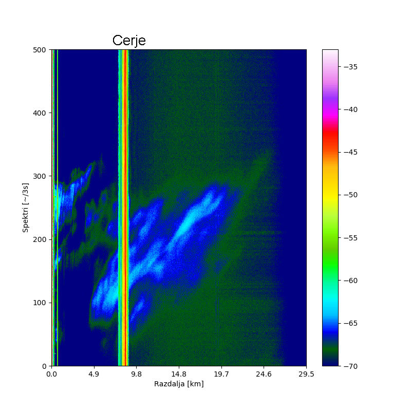

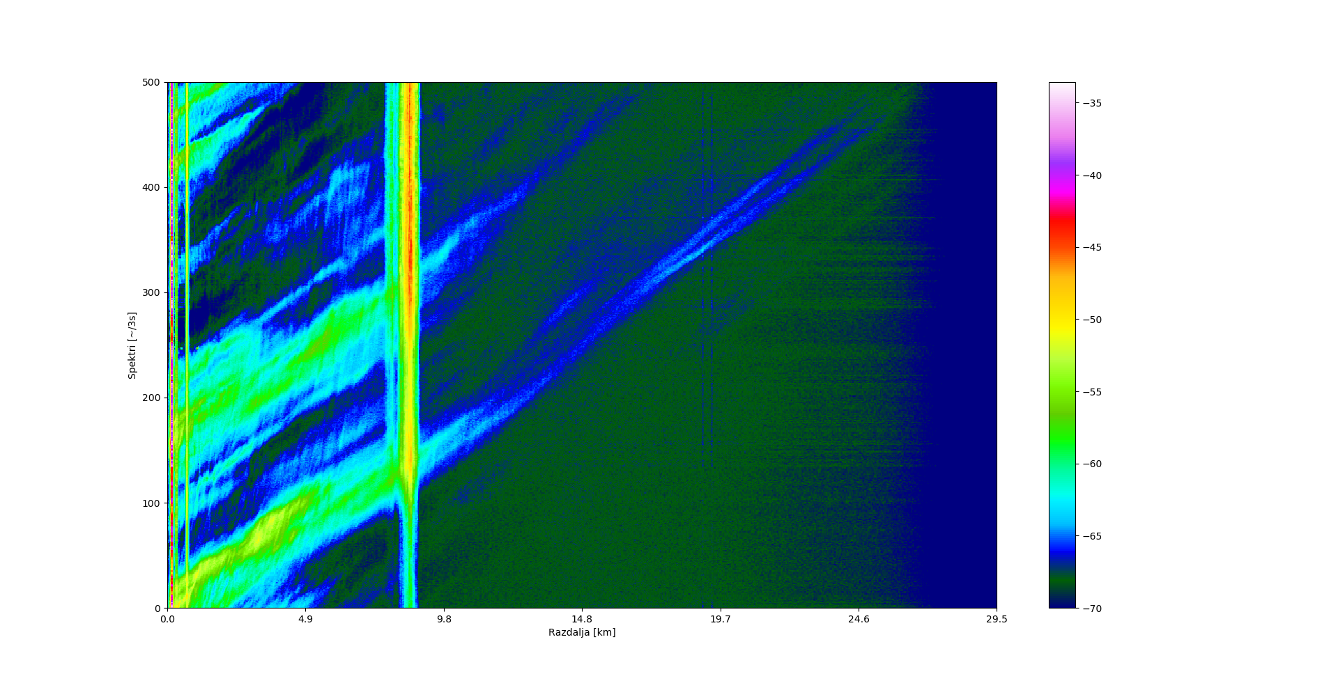

The development of short localized thunderstorms is best observed as a waterfall spectrogram at low elevation in the direction NW on June 3rd, 2025:
NW

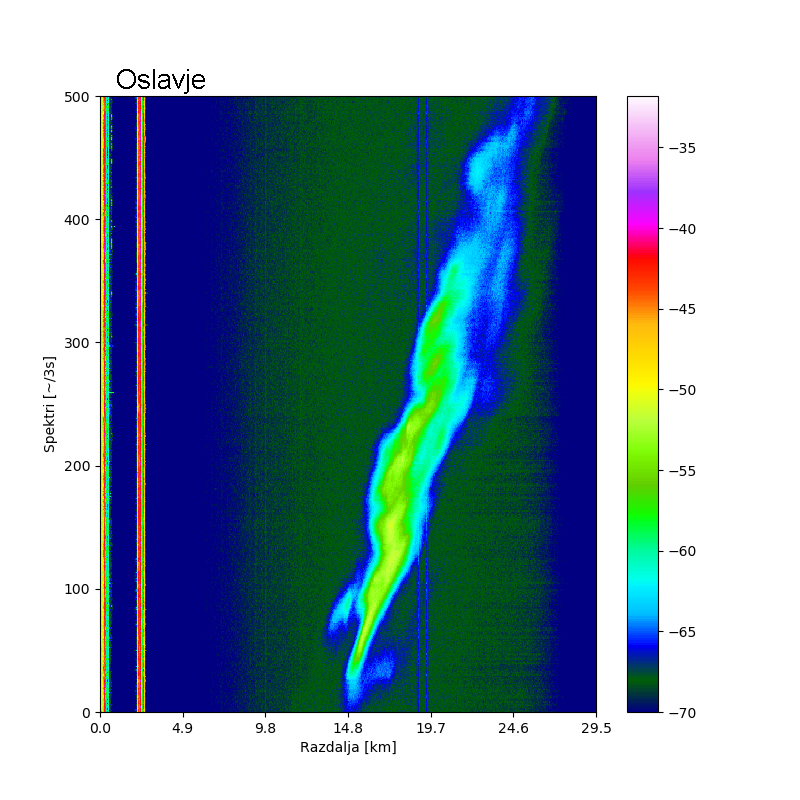

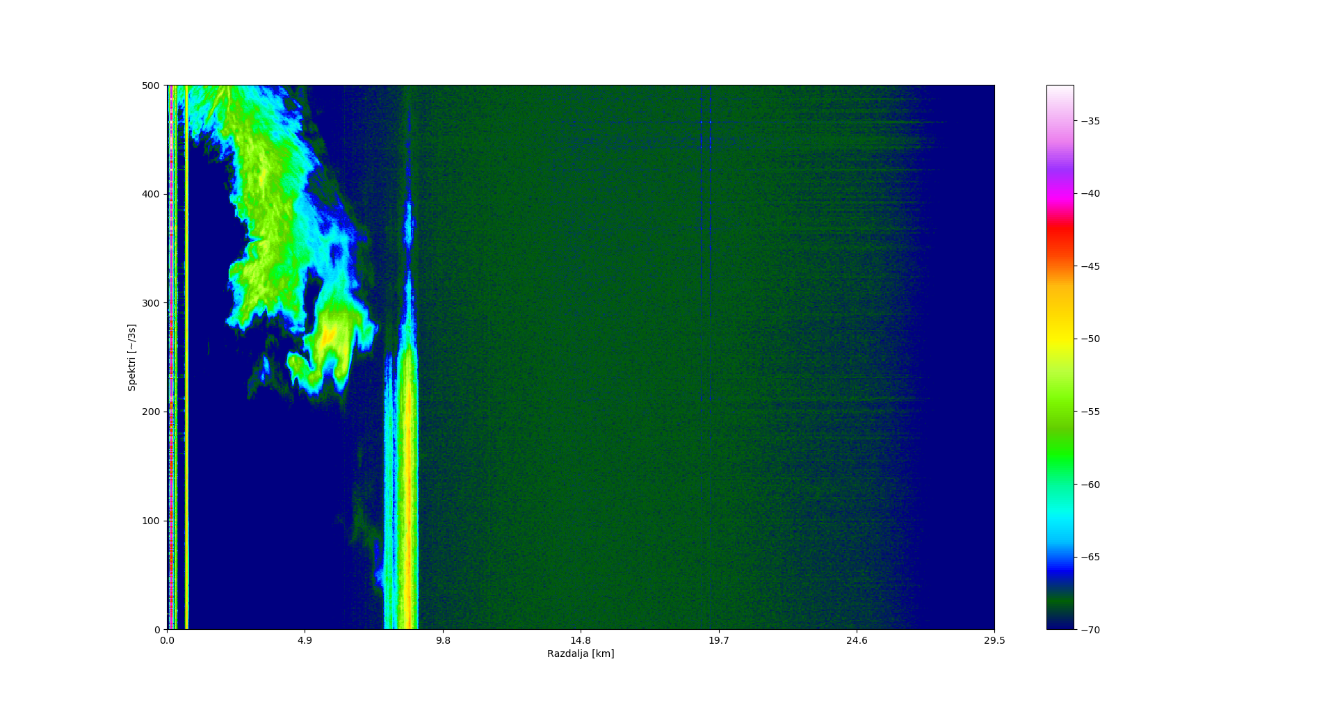

or as a waterfall spectrogram at even lower elevation in the direction S on June 5th, 2025:
S

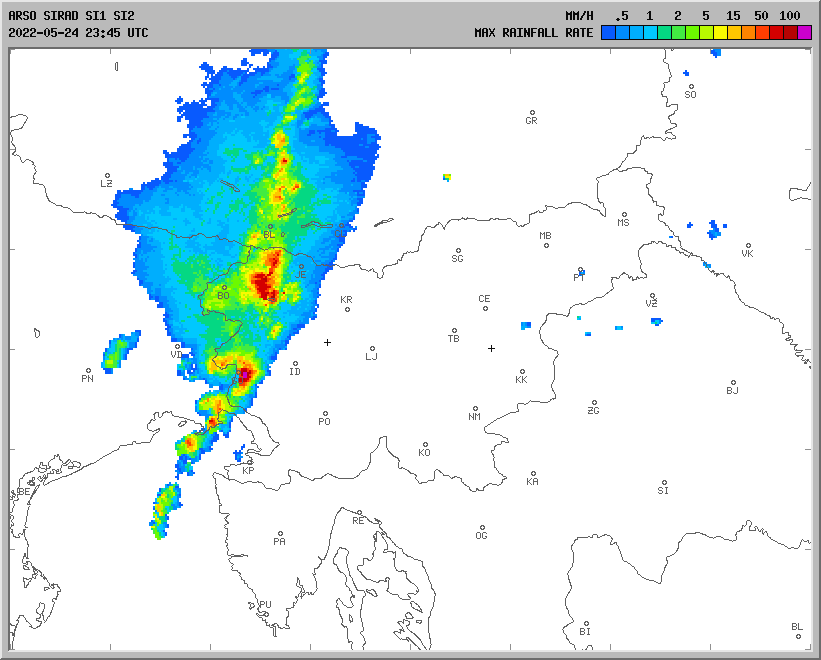

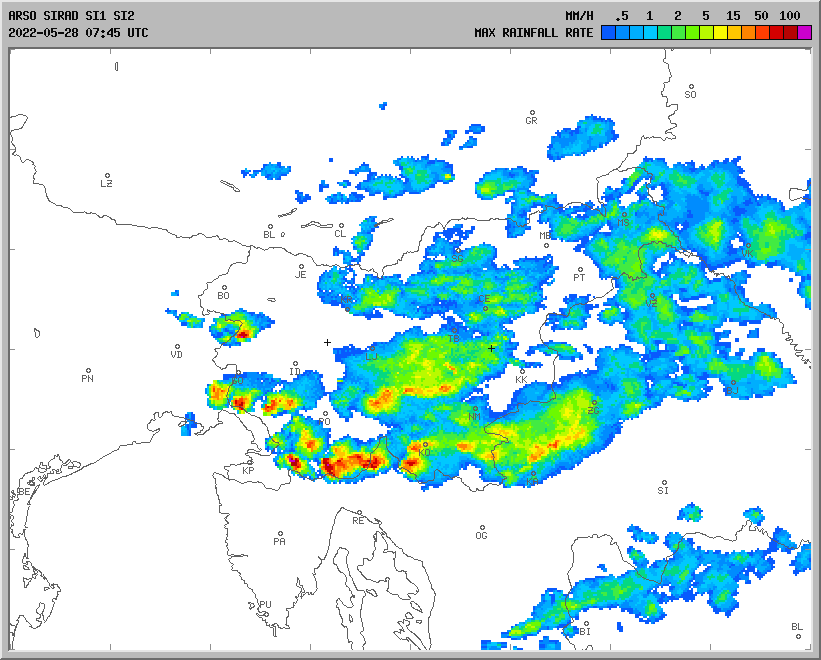

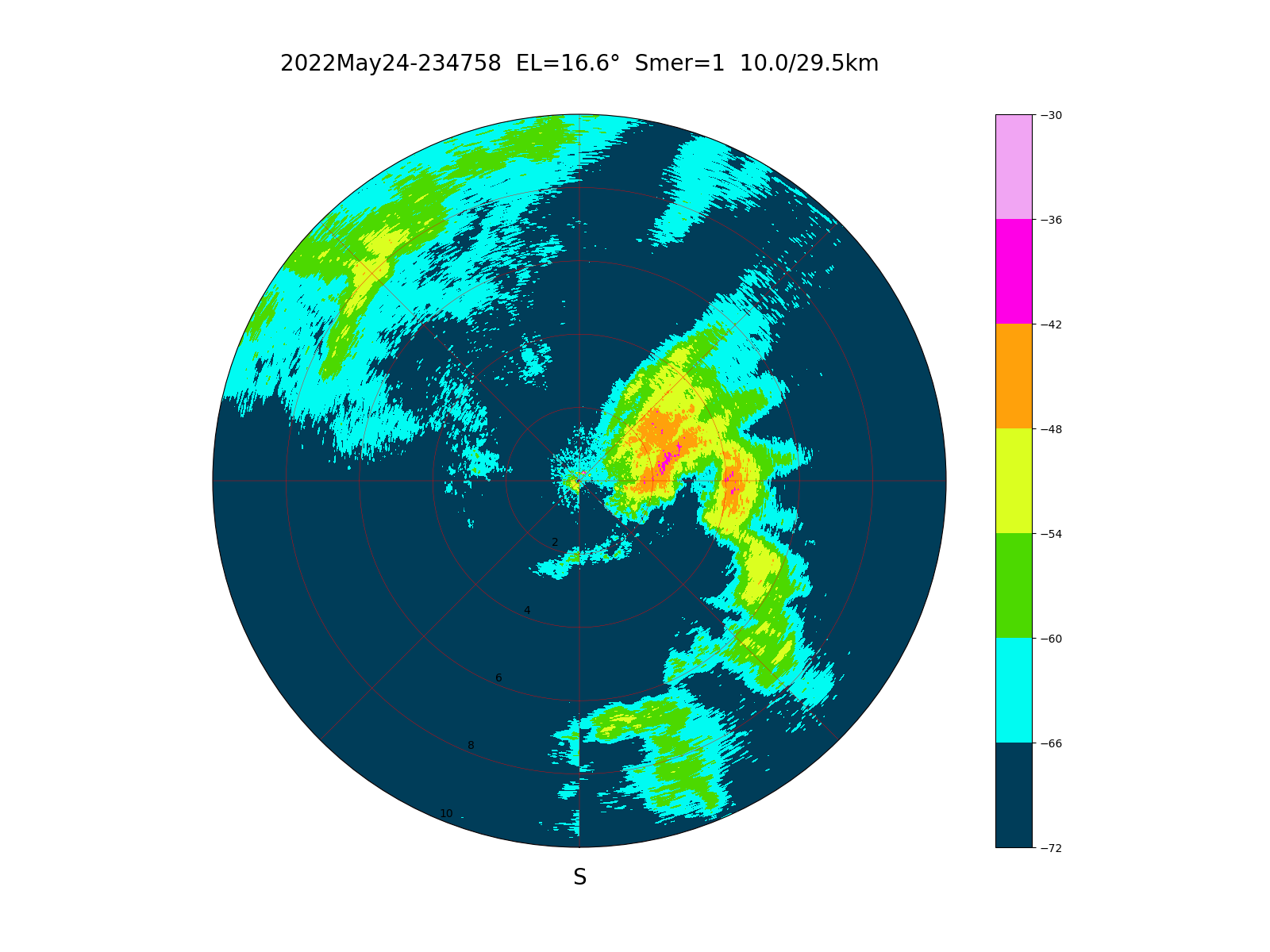

Data from a small weather radar can not always be trusted. The ARSO radar image of a heavy rainfall in Nova Gorica shown below:
rain
The scanning of the small weather radar was form weast to east. There is almost no rainfall in the last quadrant from east to south within 1km range. What really happened? In spite of the high elevation almost 17 degrees rain water temporarily flooded both feedhorns while the antenna facing east:
F1
Without radome the rainfall is much weaker in the last quadrant from east to south within 10km range. The feedhorns only dried up back to normal sensitivity the next day:
F10

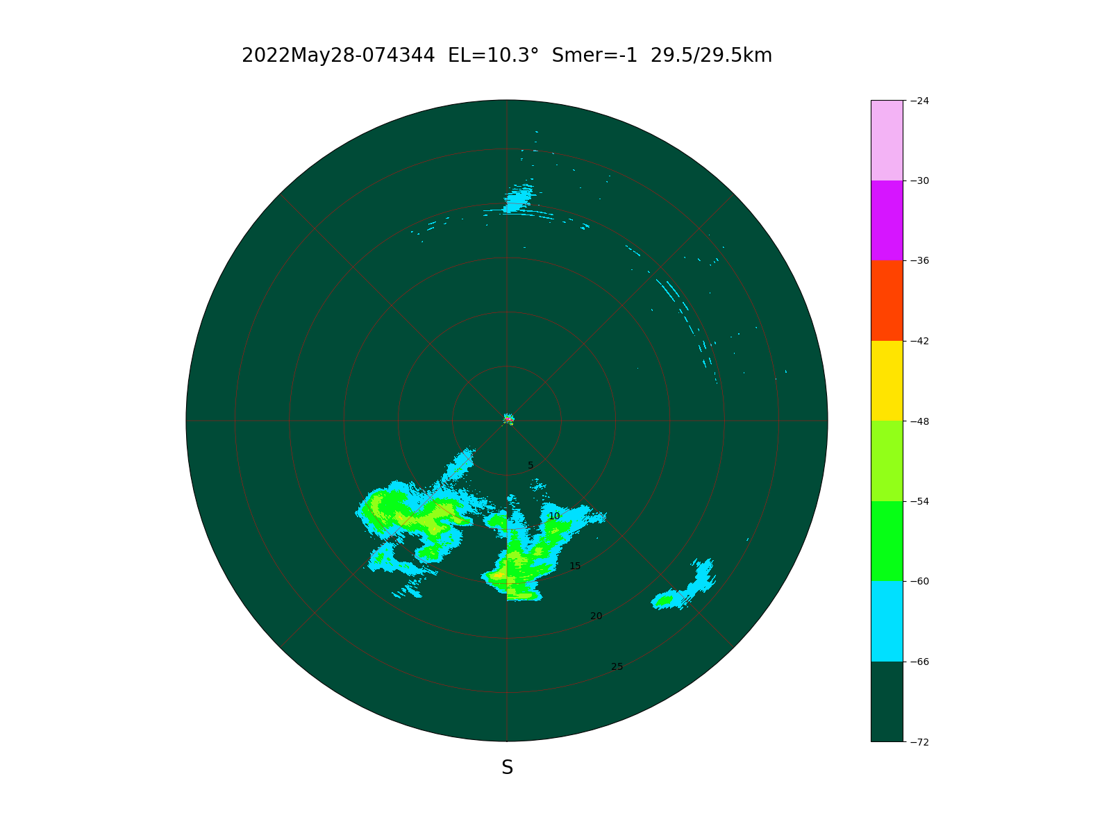

At 10 degrees elevation rainfall in most directions can be observed up to a distance of 25km due to Earth's curvature:
ARSO28
25km

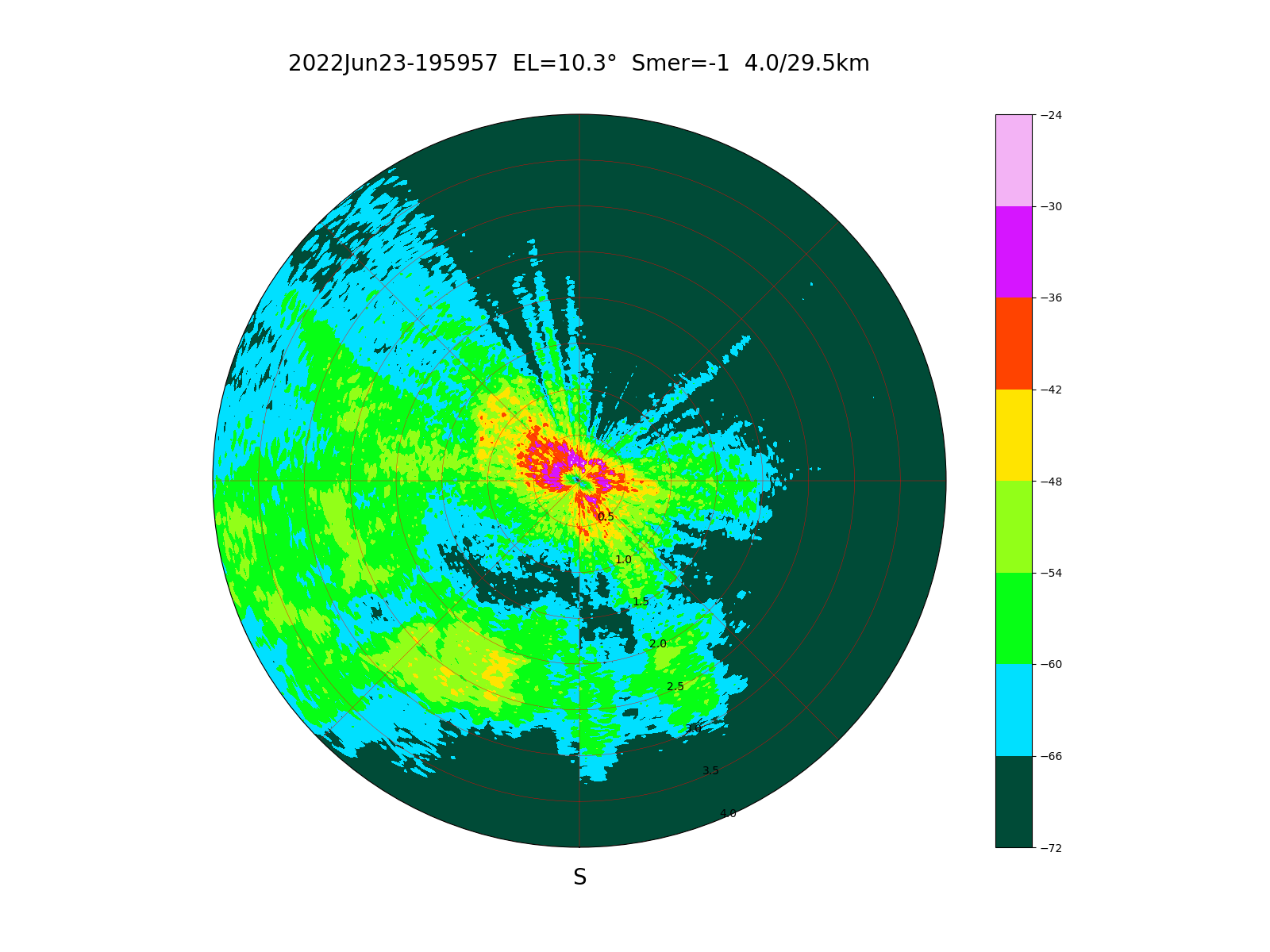

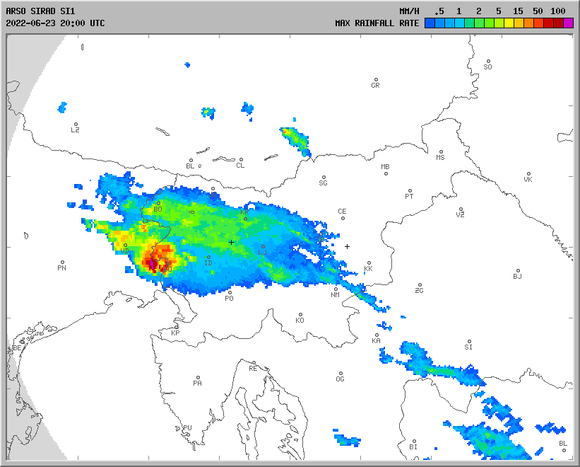

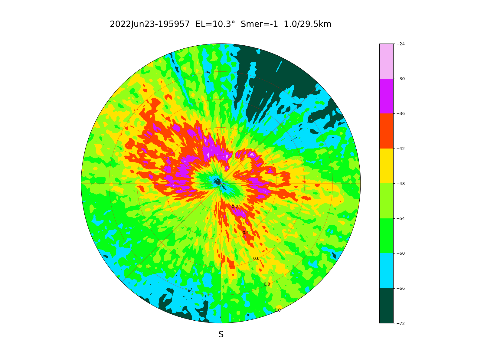

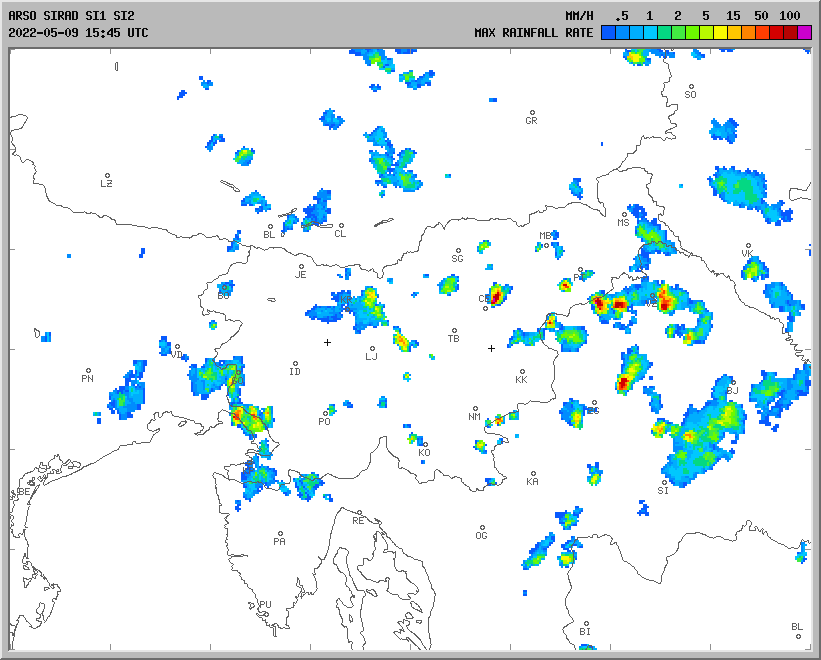

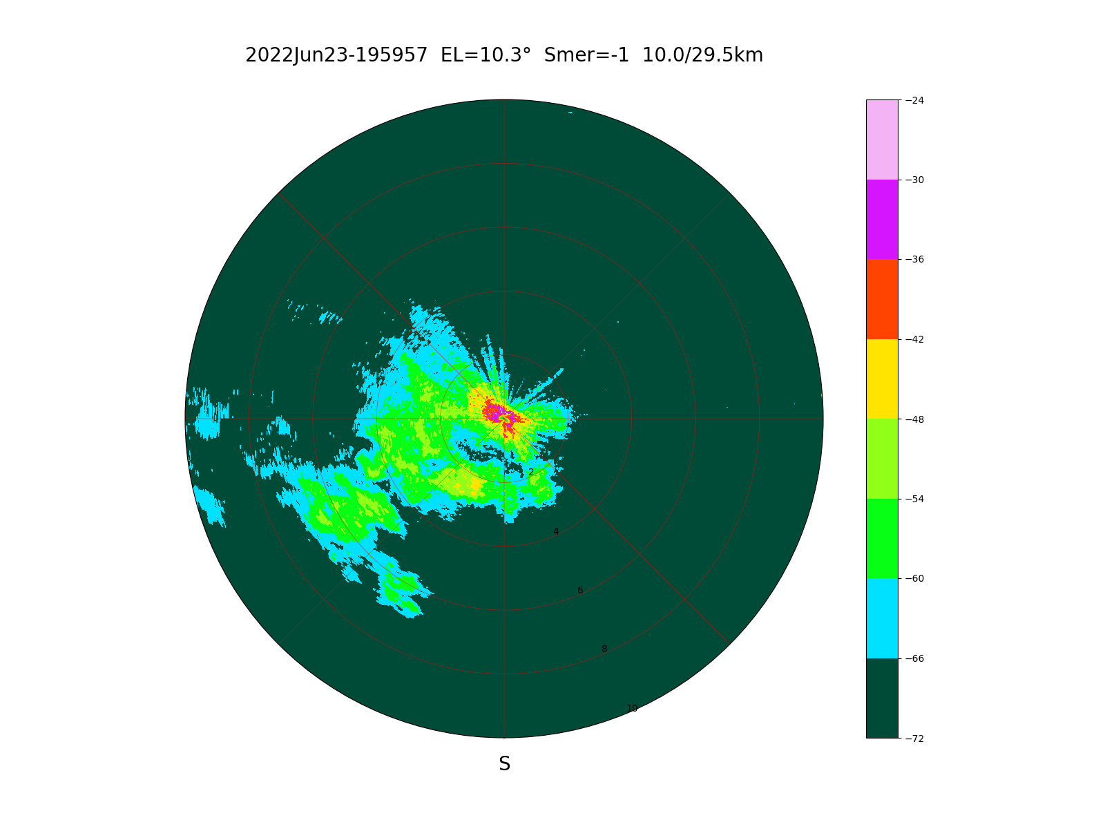

On june 23rd, 2022 precipitations were centered on my location:
ARSO23
Most precipitations are visible within 1km:
C1
Precipitations already look weaker within 4km:
C4
Within 10km the attenuation at 10GHz is already noticeable:
C10

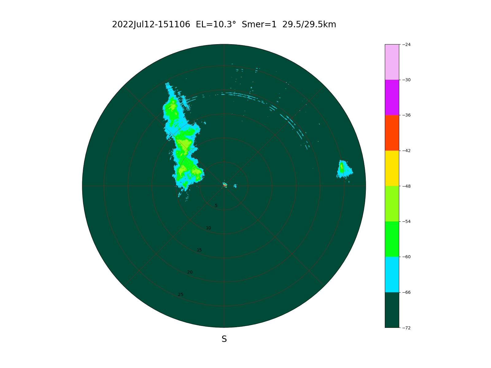

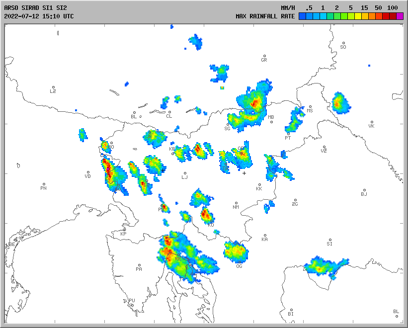

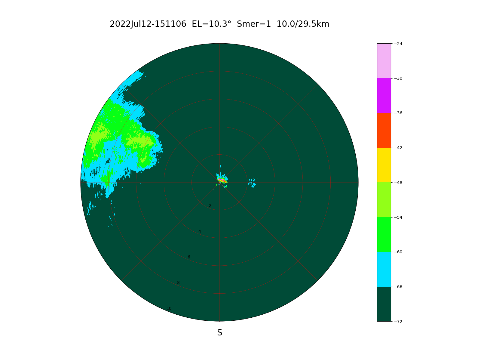

Precipitations and ground obstacles are visible on July 12th, 2022:
ARSO12
Precipitations and ground obstacles within 10km:
B10
Including some interference within 29km:
B29

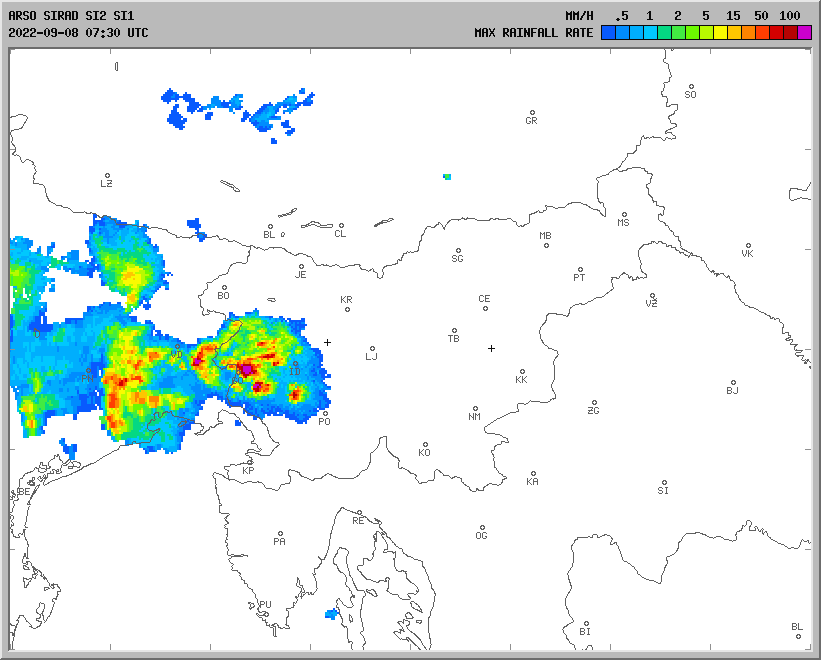

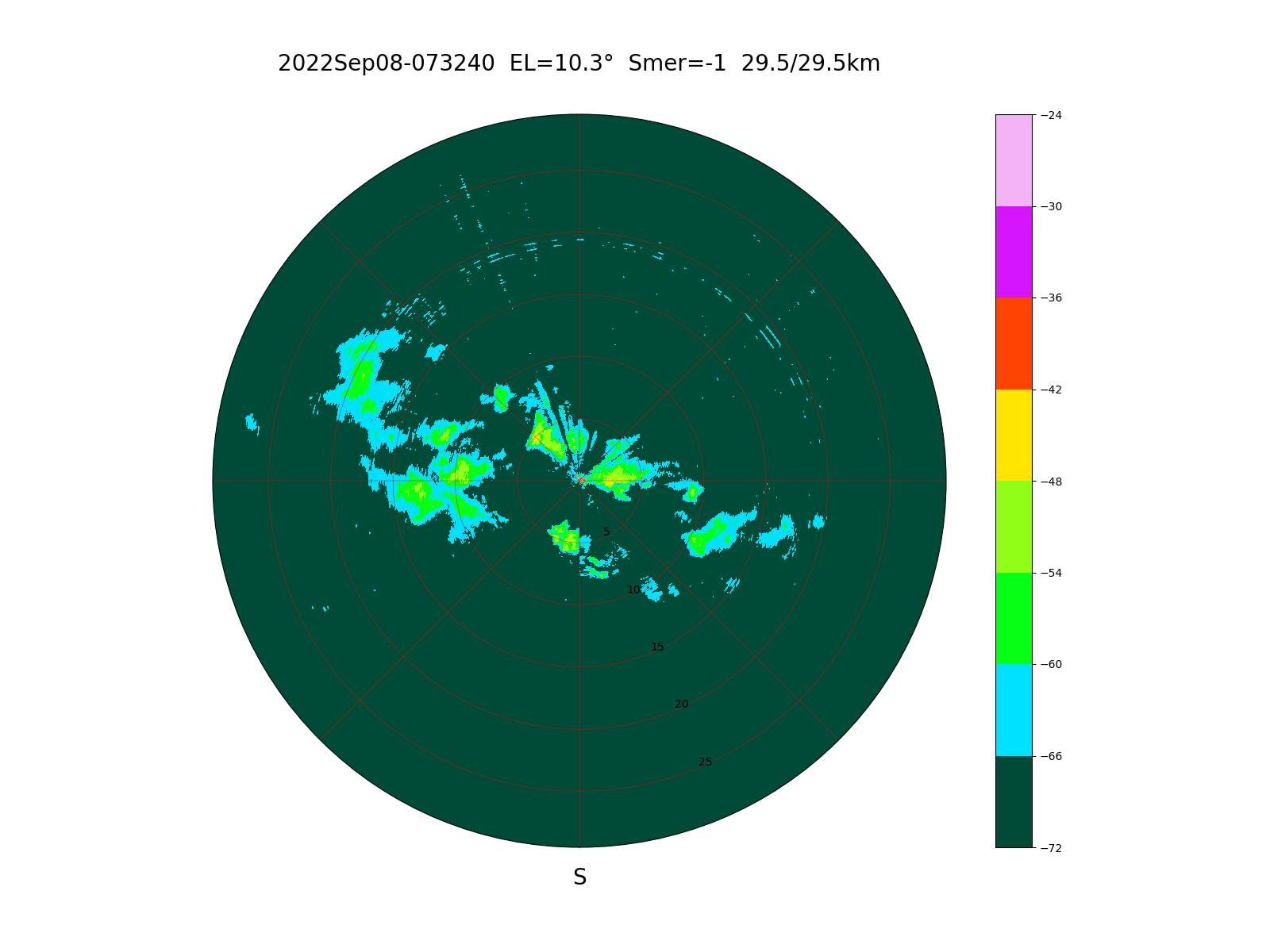

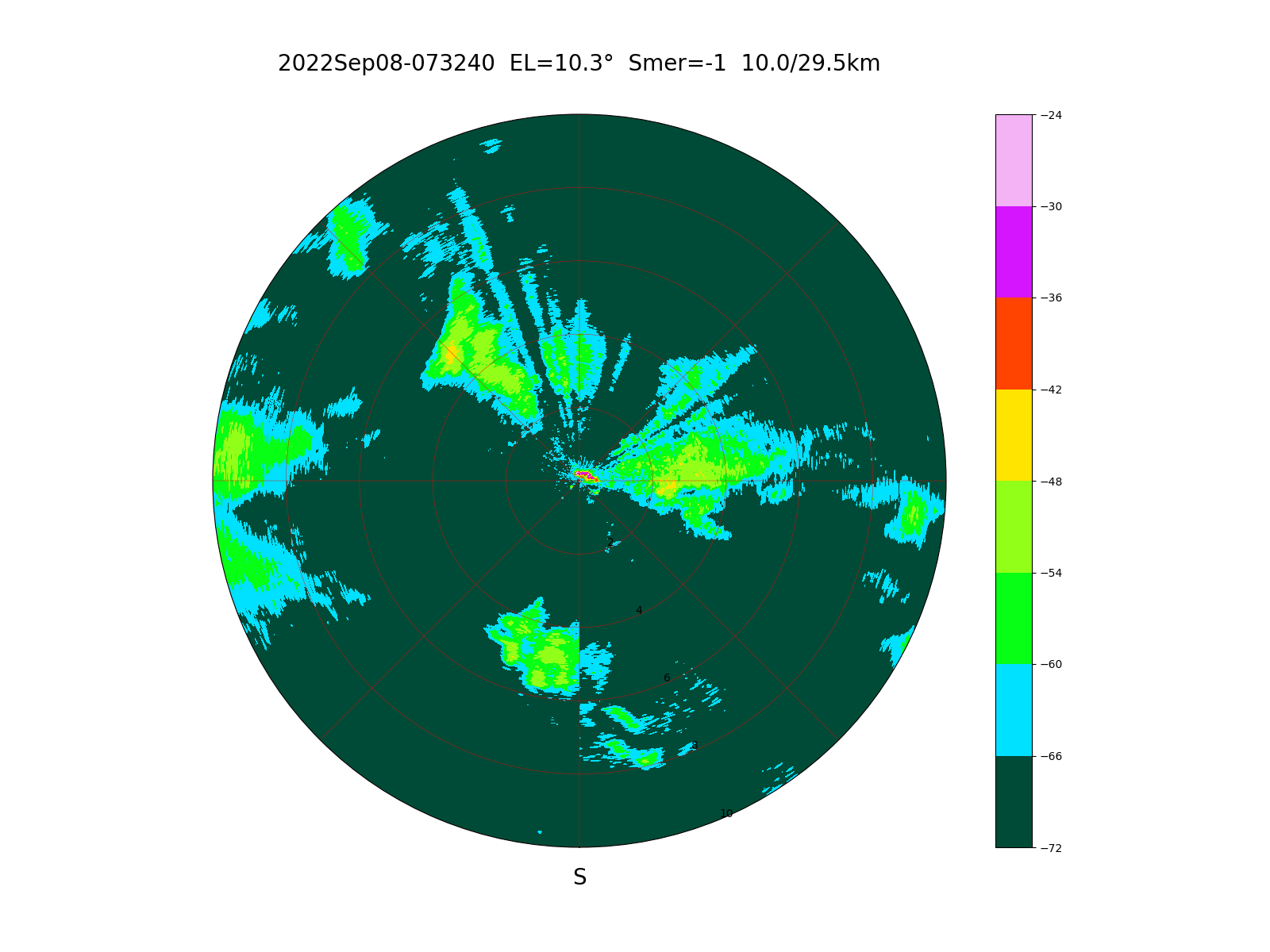

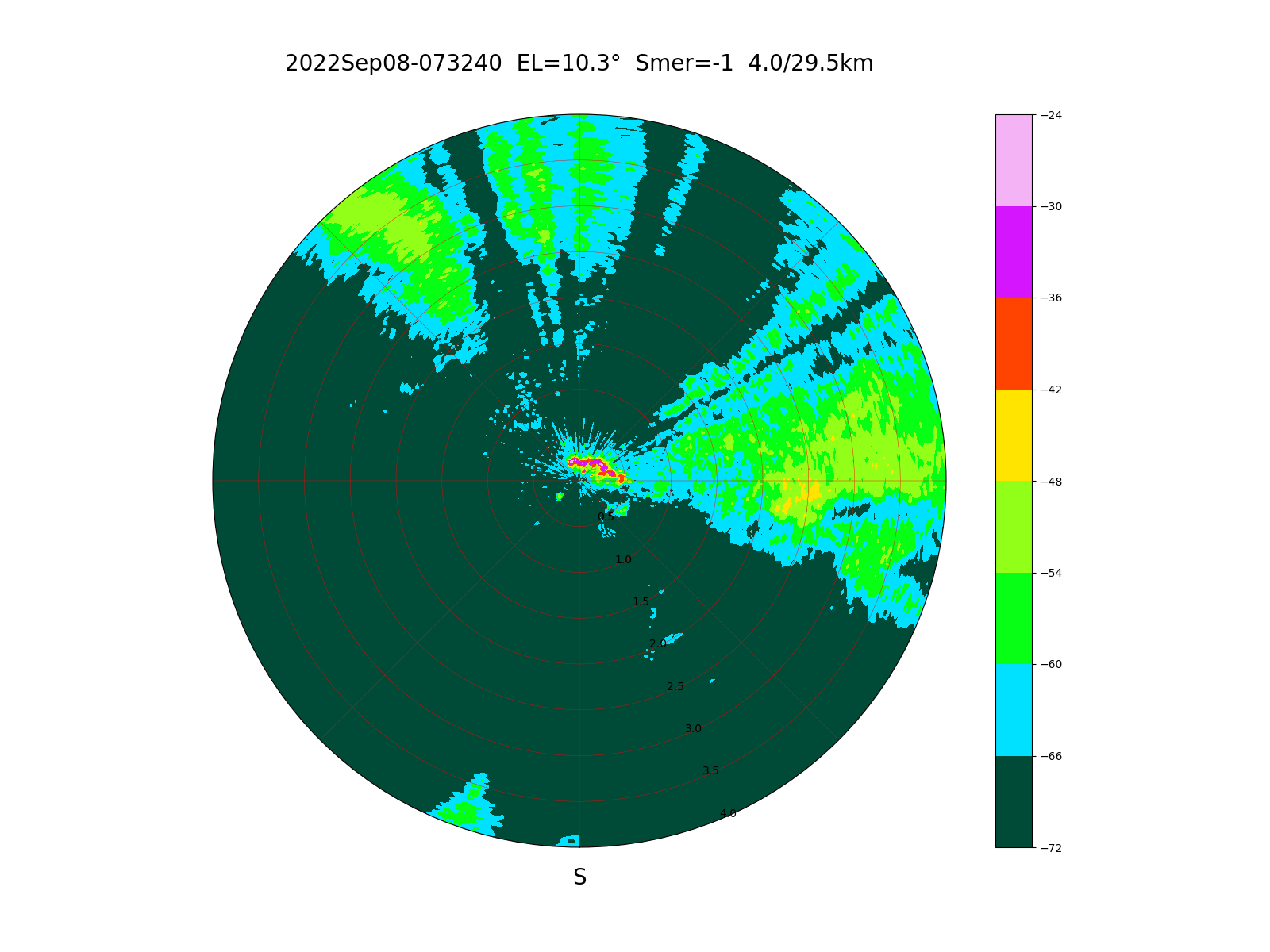

Sevaral smaller storms are visible on September 8th, 2022:
ARSO8
M4
M10
M29

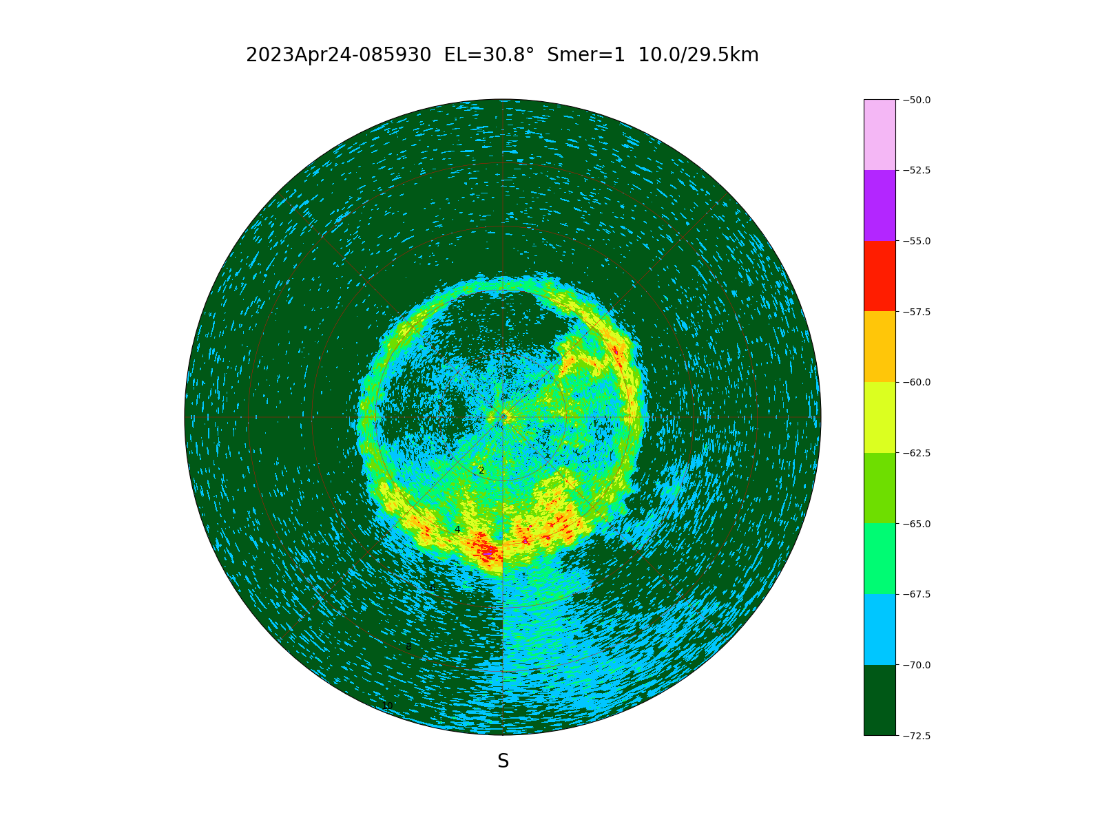

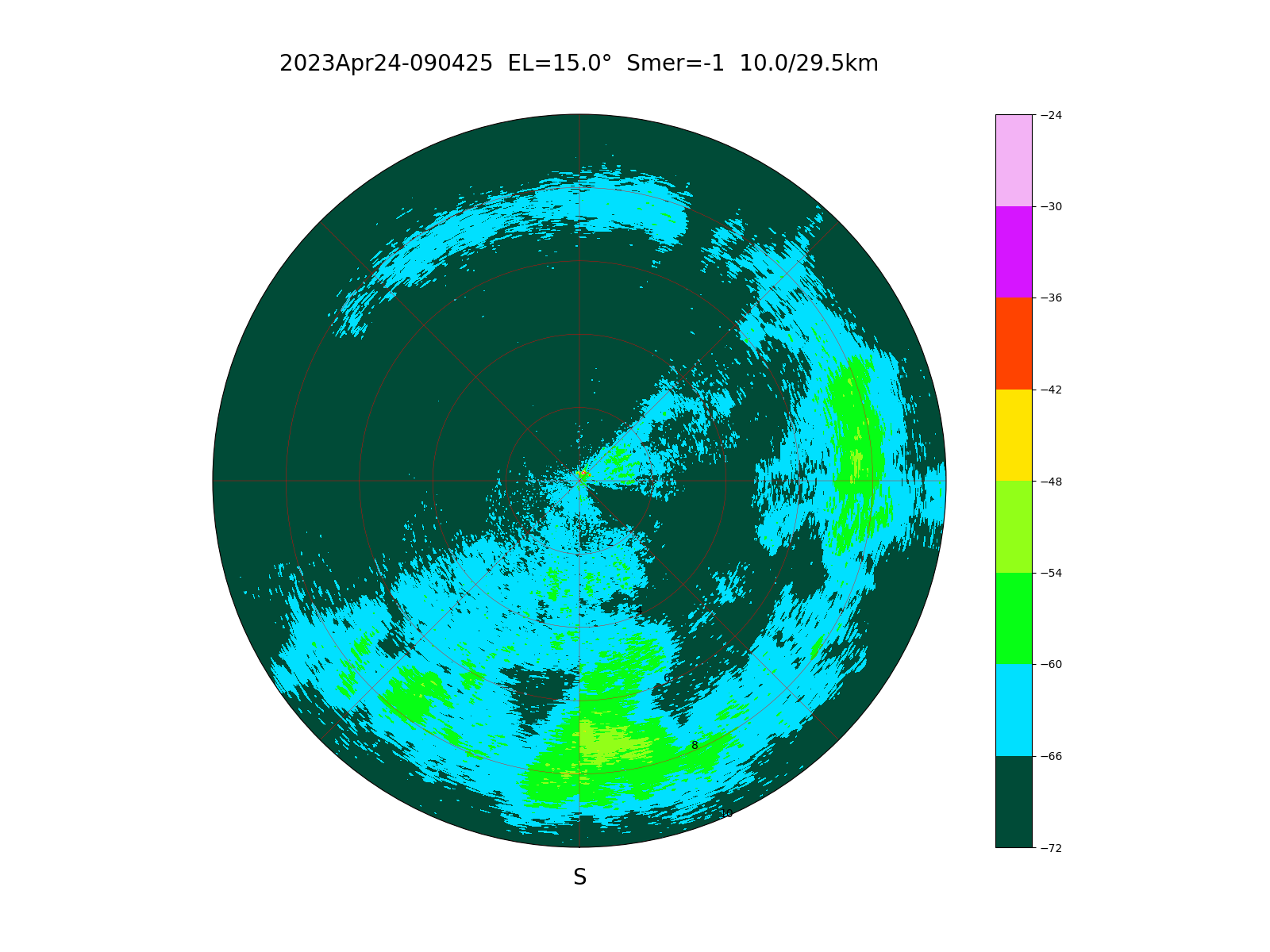

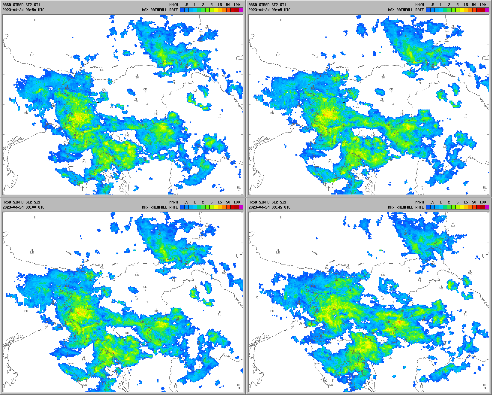

On April 24th, 2023 the sky in Nova Gorica was overcast with light rain. Several images of the local ARSO weather radar are shown for comparison:
ARSO24

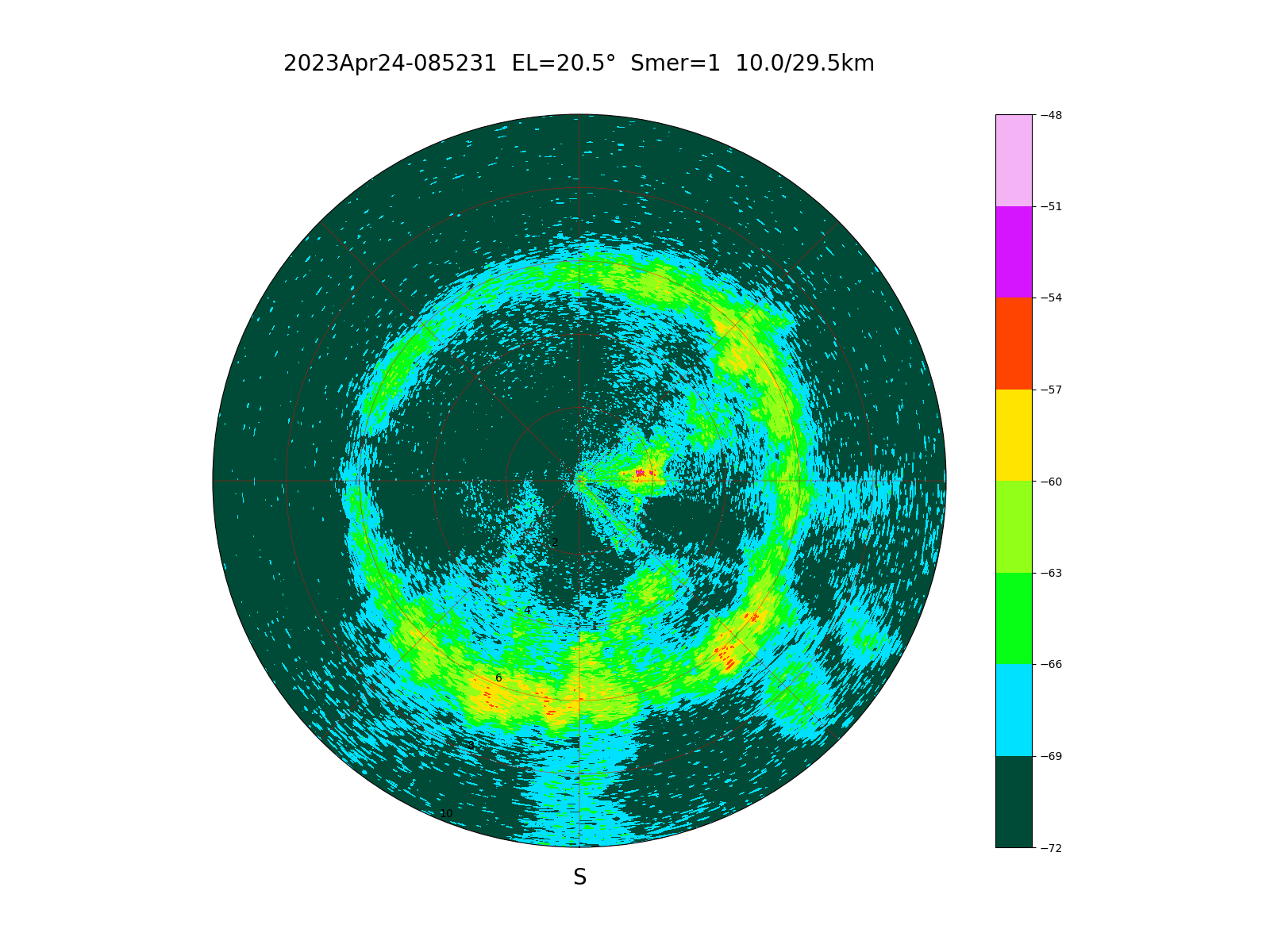

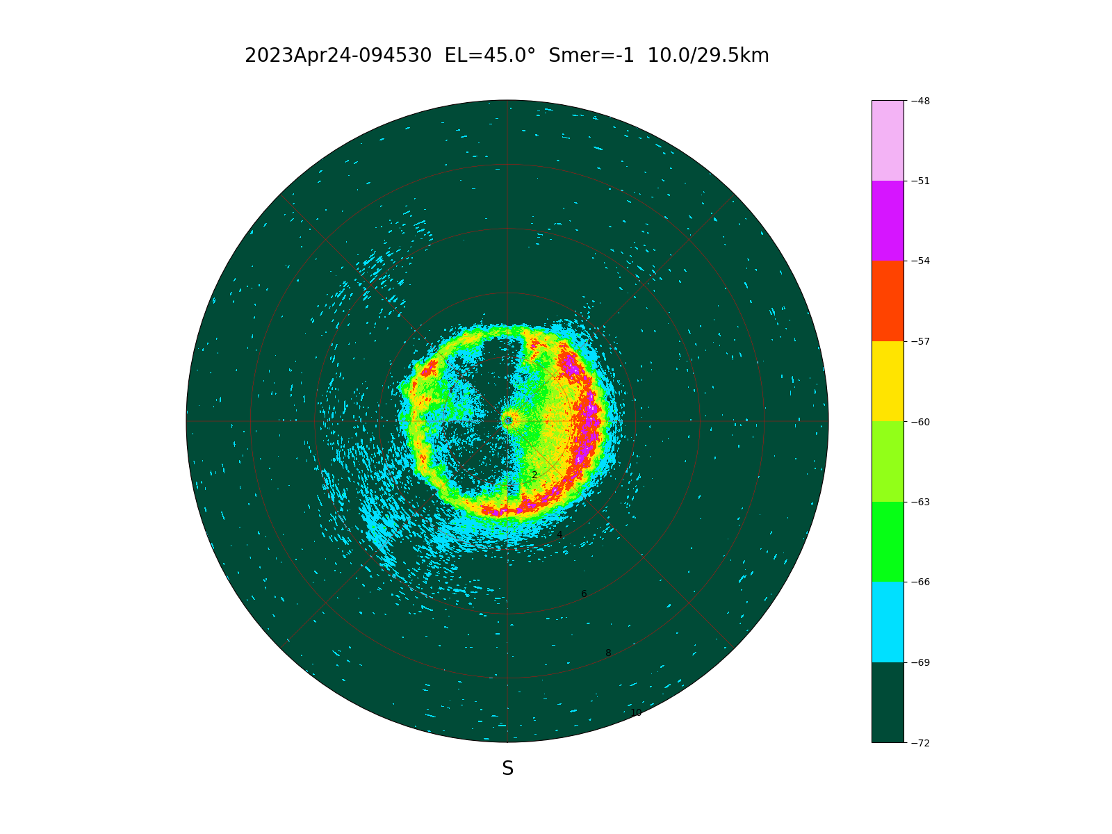

Several scans were made at different elevations. The radar reflection is much increased at altitudes, where snow flakes (large area) into much smaller rain drops with a high dielectric permittivity. The melting of snow flakes apears as rings at altitudes given by the antenna elevation. Some weather radars combine the measurements taken at different elevations resulting in several concentric rigns on a single image.
The broadest ring appears at 15 degrees elevation:
el15
A slightly smaller ring appears at 20 degrees elevation:

The smallest ring appears at 45 degrees elevation, where the ring radius equals the melting altitude between 2km and 3km:
el45
As a conclusion, several different natural weather effects can be observed with a FMCW radar with relatively small antennas and a transmitter power level of just 30mW at distances up to 25km, this range being limited by the Earth's curvature.
