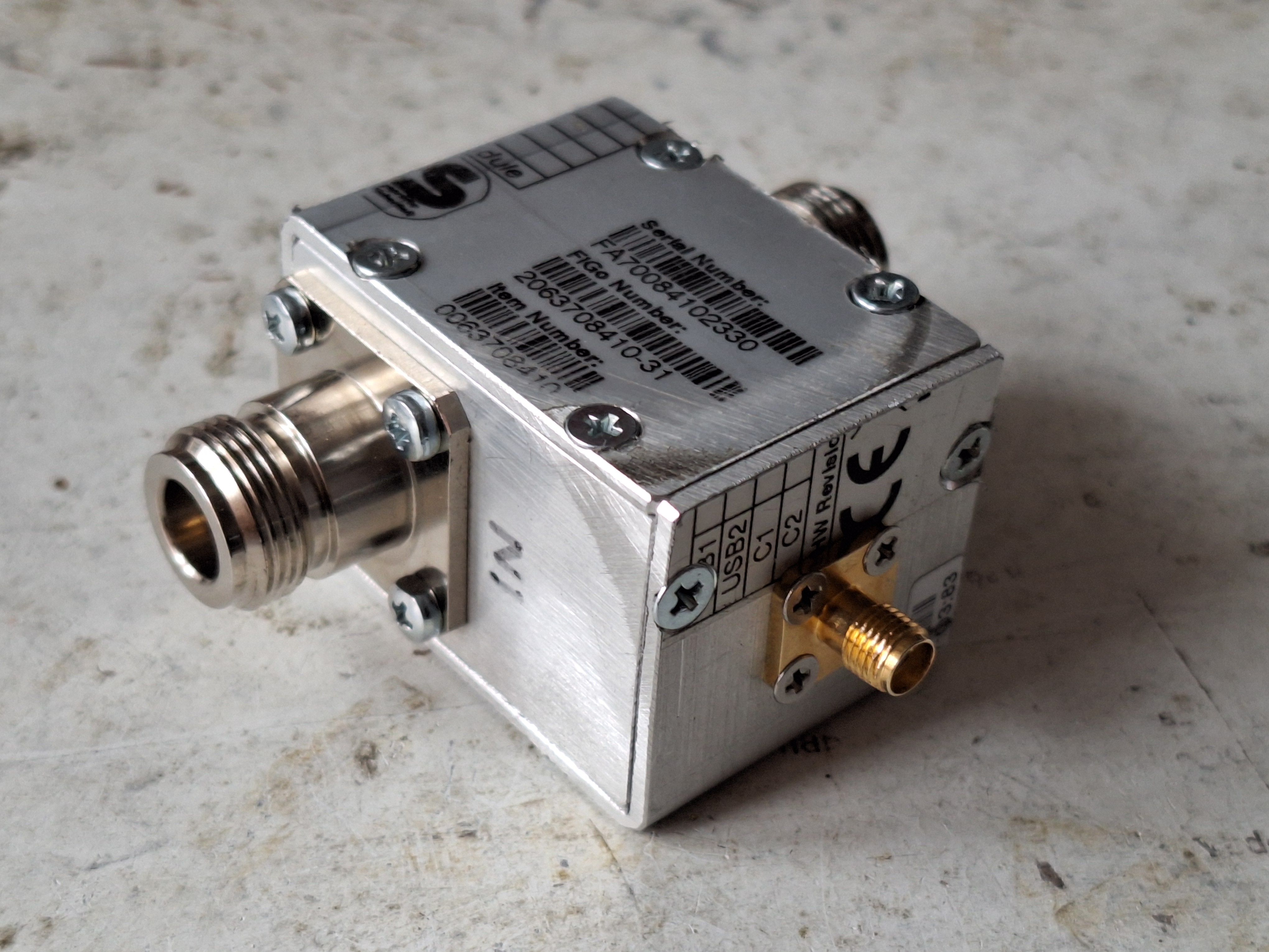

RF Power Sampler -44dB(-48dB), from 1.8MHz to 150MHz
RF Power Sampler, 50 Ohm, N-N, SMA

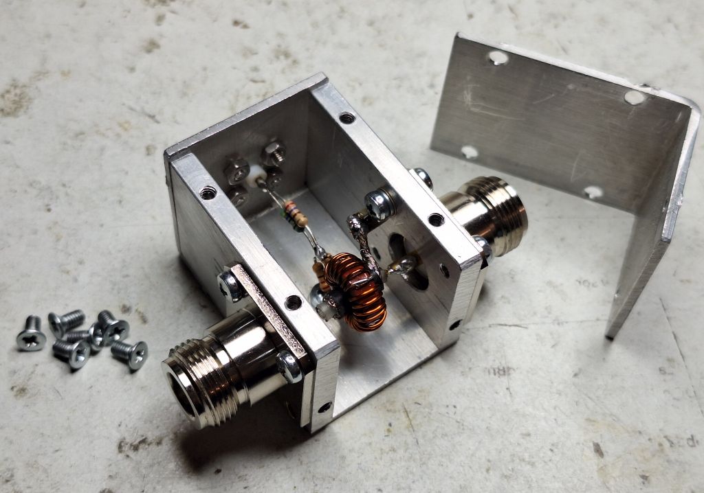

Inside Alu Enclosure

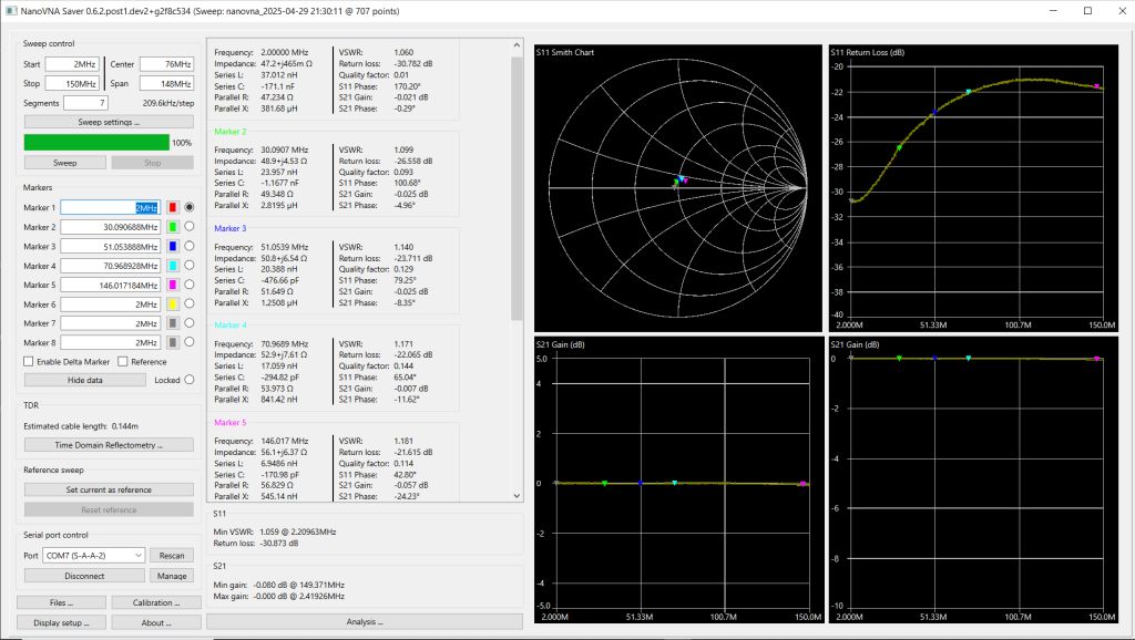

Rev.1: -44dB, core T50-2, Primary 1T RG-58, Secondary 18T
Frequency Response 2MHz to 150MHz
Insertion Loss 2MHz to 150MHz

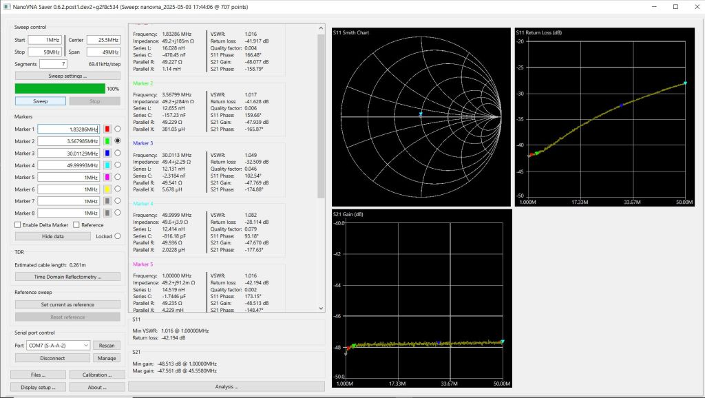

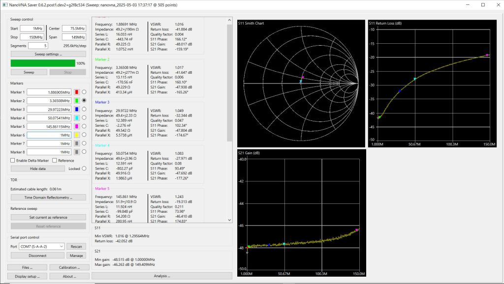

Rev.2: -48dB, core T44-2, Primary 1T RG-141, Secondary 27T
Frequency Response 1MHz to 50MHz
Frequency Response 1MHz to 150MHz
