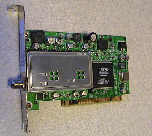

The cheapest thing I could find that contained a suitable tuner was the "Sky Star 2" PCI card that is used for reception of digital TV and/or data broadcasts from satellites with a PC. It loks like this:
A pic of the SkyStar PCI card
It costs cca 70 euro, not really much cheaper than the cheapest set-top boxes.

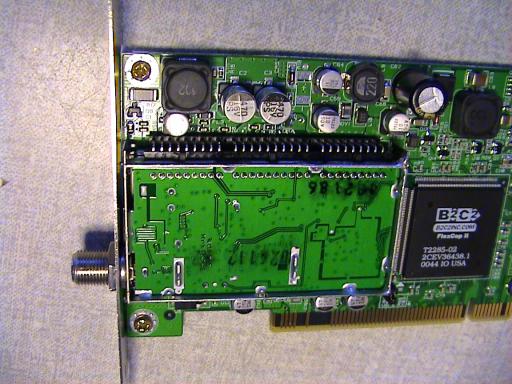

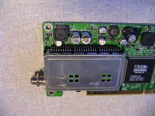

First I tried to see if the tuner is of the right (direct conversion) type, so I could eventually return the cards for refund if the tuner was not suitable. But removing the top cover of the tuner only revealed the bottom side of its PCB:
A pic of the tuner with top cover removed
so I would have to remove the tuner to see its guts - making a return impossible.
I started by removing the metal plate (two screws plus the nut on the F connector):
Sky star with the metal plate removed

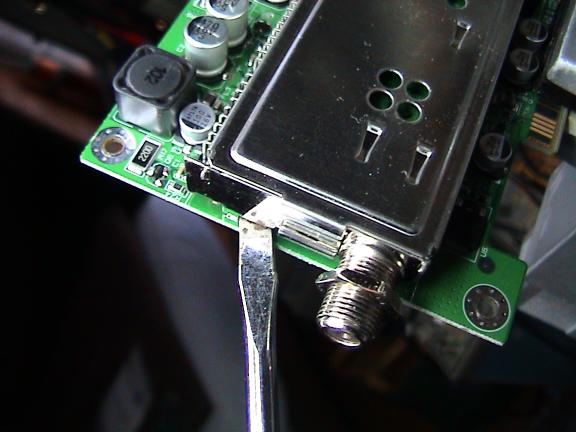

Besides the electrical connections, the tuner is fixed to the PCB using four metal pins (extensions from the rim shield) soldered through holes. Wedging a screwdriver under the tuner like this:
A screwdriver wedged under the tuner

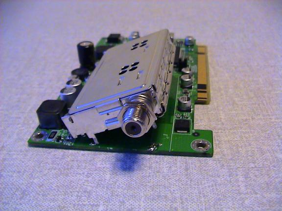

and working the four pins in a roun-robin fashion with a soldering iron, it is possible to lift the tuner like this:
tuner lifted, hanging by the signal pins

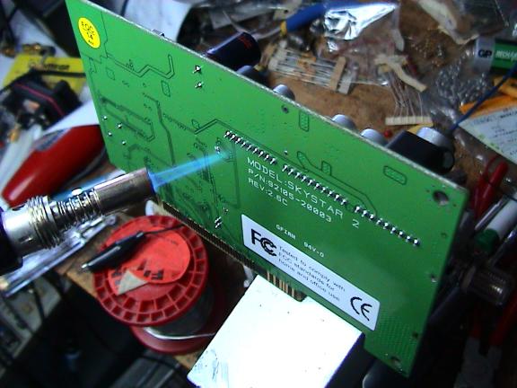

Now it remains to unsolder the row of pins. The problem is you need to make the solder flow on all of the pins simultaneously. I used an Weller "Pyropen junior" in naked flame mode (tip removed) like this:
Desoldering with a naked flame

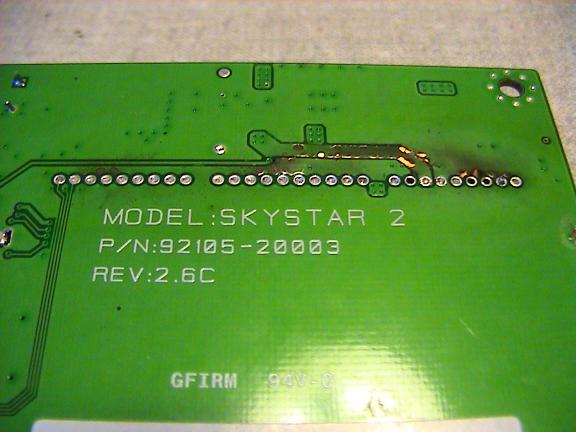

The tuner came off quite easily, without too much damage to the board:
The board after tuner removal
I bet with some practice (like removing 5 tuners) one could do it with no visible damage at all. But in my case the boards were condemned to the dustbin anyway....

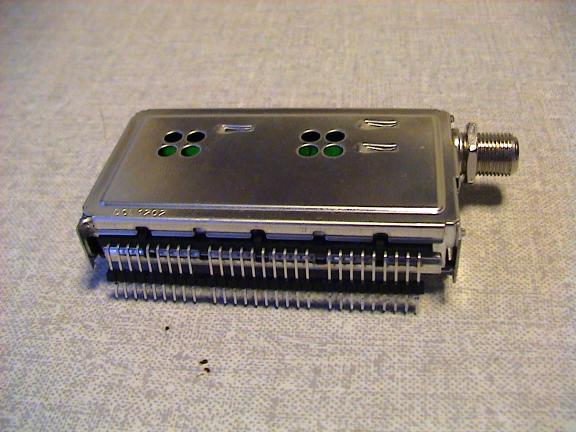

Now I got the tuner:
The tuner after removal
Looks kinda nice, eh?
It is marked "SAMSUNG DCI 1201" and "TBMU24112IMB1", but searching the web for these strings brought nothing.

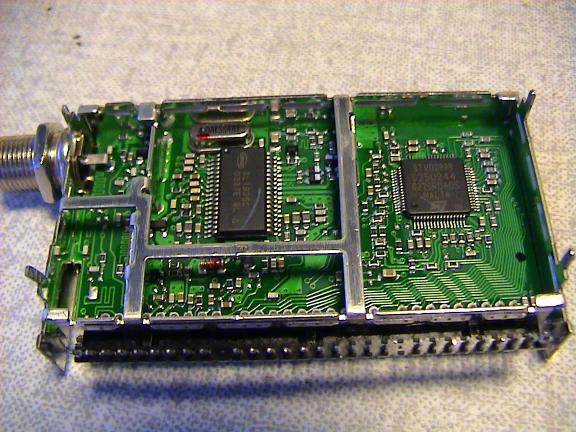

Opening it up:
Inside of tuner
I could see a Zarlink SL1935C and a SGS-Thompson STV0299B. It was easy to get PDF's for these on the web. The first one is a complete front end that converts from the 950..2150 MHz band directly to baseband I and Q - exactly what we need. The second chip is a "Link Chip" (A/D converter, QPSK demodulator, FEC etc etc), which we don't need. Above the left chip is the quartz crystal for the synthesizer reference, which will have to be removed and replaced with an external clock.

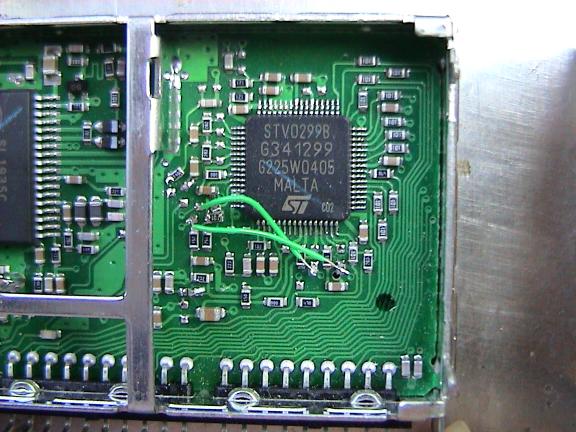

So I decided to do the following modifications on the tuners:
1. Wire the I2C bus around the STV chip
2. Disconnect the I and Q from the STV chip to prevent unnecessary loading and possible QRM
3. Because there are two tuners in a 2-channel SIDI, it is necesarry to change the address of one of the SL chips so they can coexist on the same bus.
4. Remove the reference quartz and make an external clock input.
5. Sever the clock line to the STV chip

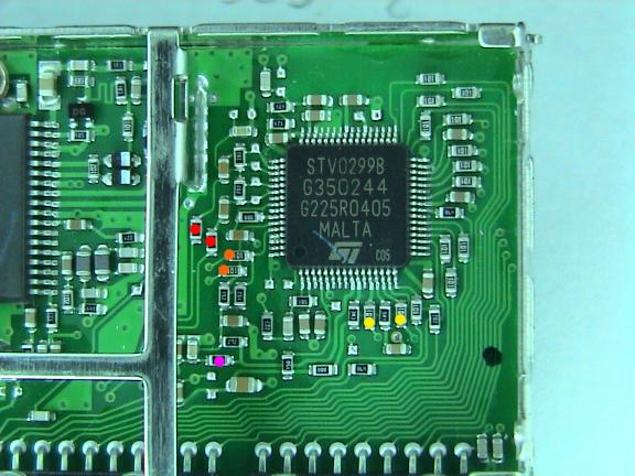

The components in the tuner are of 0402 size, so before starting with the work, do have a beer or whatever it takes to sharpen your eyes and stop your fingers trembling.
Luckily, most of the lines have series resistors for QRM reduction, so suitable solder pads are available for the modifications. I have left the series resistors in the I2C lines - just 'lifted' the resistors so that they stand on one end and connected the wires to theit top.
I have marked the resistors that have to be lifted or removed in the following picture (before modification):
Points for modification
Red dots: remove resistor (I and Q to STV)
Orange dots: remove resistor (I2C between SL and STV)
Yellow dots: lift the resistors and leave them standing on the yellow dot side (I2C to tuner pins)
Purple dot: remove resistor (AGC from STV)
Now, using thin wire-wrap wire, connect top orange point with the resistor standing on the left yellow dot.
Then connect the bottom orange dot with the resistor standing on the right yellow dot.
After these mods it should look similar to this:
tuner after modification
Maybe you can notice that I haven't totally removed the "red" and "orange" resistors, just lifted one side - for the extremely unlikely case that I would ever want to return the tuners to their original state. I don't really recommend this, since it increases the risk of accidental shorts.

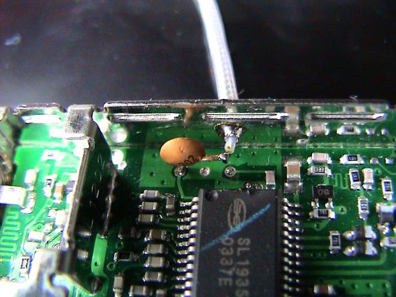

Now remove the 4MHz quartz by desoldering its two terminals. This is also a good time to cut the line that feeds the clock to the STV chip.
Next drill a 2.5 or 3mm hole into the tuner side wall, next to where the xtal was. From the outside, solder a piece of RG181 or similar thin coax to the wall. Connect the center conductor to the left xtal terminal through a small 1nF capacitor:
External clock input
This will be the input for the external clock.

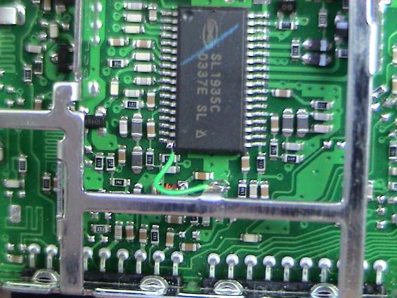

Now in only one of the two tuners, connect pin 18 of the SL chip to the ground (green wire):
Grounding pin 18
This will change its address on the I2C bus from 1 to 0.
