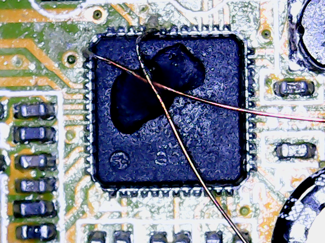

The RTL2832U chip has an 8bit GPIO port that can be used for things like
switching antennas, filters, preamplifiers, attenuators...
(Once upon the time, we used the printer port for that, but these are gone...)
The GPIO port pins are kind of randomly thrown around the RTL2832U package:
P0 = pin 37 P1 = pin 32 P2 = pin 31 P3 = pin 36 P4 = pin 30 P5 = pin 29 P6 = pin 22 P7 = pin 21In my R820T based dongle, none of them is used internally, and the pins are soldered to unconnected pads.
