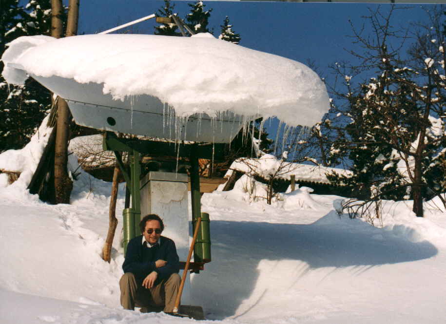

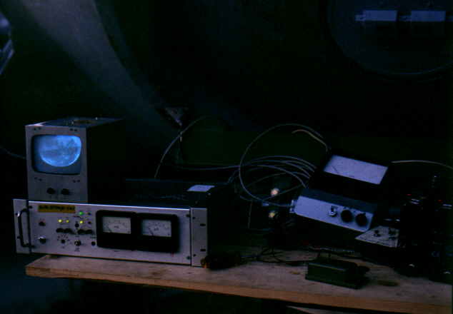

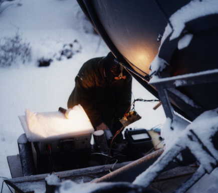

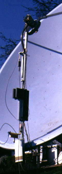

Antenna: 3m dish, TX: 50-60W, RX: 1dB NEC 325, DB6NT transverter, 2X IC202. R/T switching is done by mechanically exchanging two feedhorns with an windscreen wiper motor. Moon tracking is done with an homebrew noise detector or on the rare occasion of a clear sky, with an modified video camera.

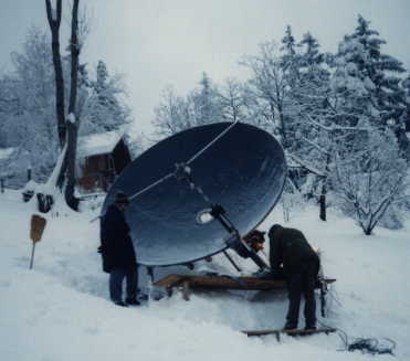

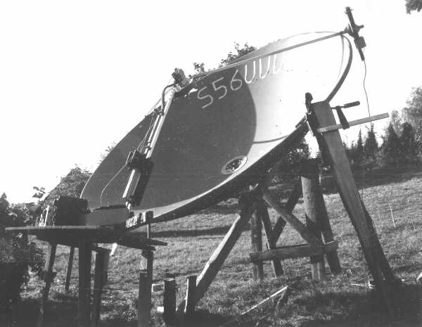

First QSO was with SM4DHN in aug 94. Further QSO's are in the 10GHz EME log. Until nov 96 I worked with an old Andrew 3m f/d 0.29 dish on improvised supports (Mk I and II). Because the dish was somewhat deformed and hard to feed efficiently (deep!), I suspect I was loosing about 2dB of signal (4dB on echo). Also, my mounts were polar, so I lost up to 3dB working linear pol with altazimuth stations.
I think we should all go to circular polarisation!!

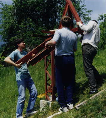

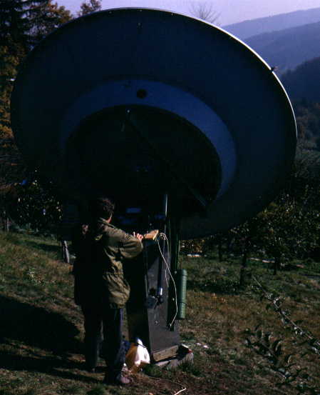

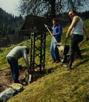

Recently (sep 98) I have installed an 'like new' RFS 3m dish on an all metal altazimuth mount with ball bearings and similar luxury.
